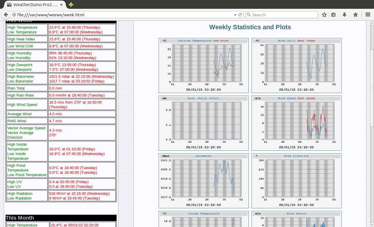

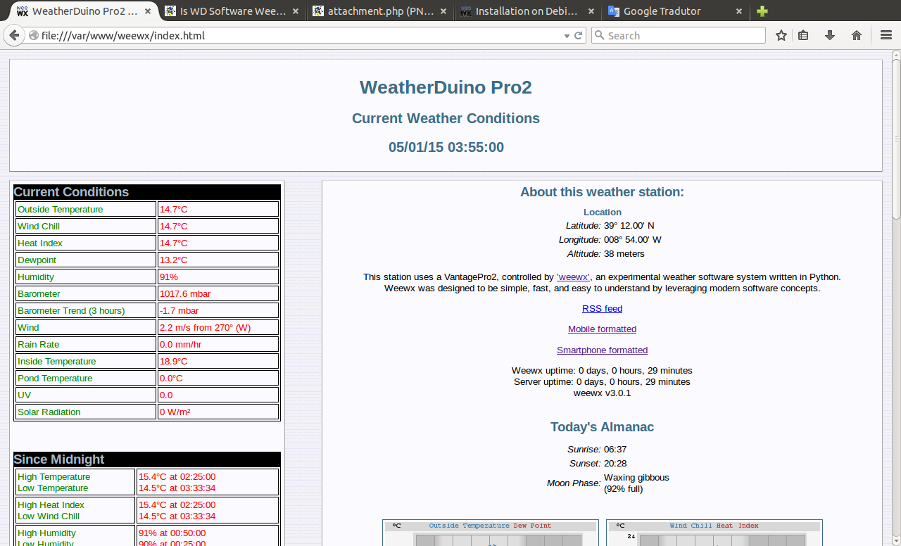

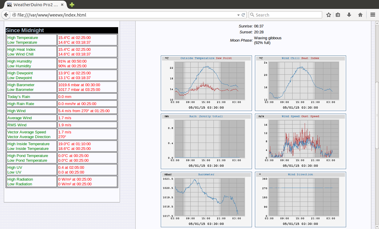

First test with WeeWX running in Ubuntu.
Install an run the lastest WeeWX version, in fact is really easy.
The WeatherDuino Pro2 receiver is recognized as a Davis Vantage, but ...
As in the first versions of Cumulus MX, the WeeWX, uses hardware handshake to handle with the serial port. If the handshaking could be changed from hardware to none, such as Steve did, I think that may be possible to use the WD Pro2 with WeeWX. I know nothing about python, and for now, I do not have time to investigate about it.
